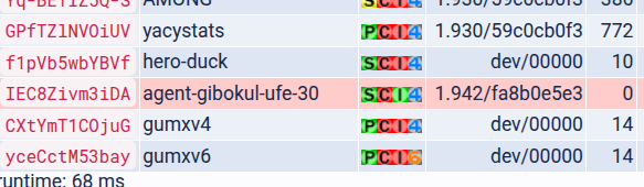

Thanks for posting this. I ran into a similar version-number issue when moving a YaCy build from Linux to Windows.
I originally built YaCy with:
ant clean all
and the peer would show up as:
dev/00000
I found that building the distribution with:
ant clean all dist
fixes the problem.

I did a quick test of the dev/00000 version issue and found something interesting.
I cloned YaCy from GitHub and built the distribution using:
git clone https://github.com/yacy/yacy_search_server.git
cd yacy_search_server
ant clean all dist
I then took the generated .tar.gz from the RELEASE directory and built a fresh Docker image from that tarball.
The important part is that the running Docker container does not contain the original .git repository.
The result was:
1.942/fa8b0e5e3
instead of:
dev/00000
So ant clean all dist appears to write the required version information into the distribution before it is packaged.
My test was:
Git clone
ant clean all dist
RELEASE/*.tar.gz
Docker image built from tar.gz
YaCy starts without .git
Version: 1.942/fa8b0e5e3
I had previously used ant clean all and then copied the installation to another machine, which resulted in dev/00000.
Using the distribution generated by ant clean all dist fixes it.
This may also provide a cleaner solution for Docker builds than replacing the fatal: not a git repository strings in yacyBuild.properties with sed: build the distribution while the Git metadata is available, then construct the runtime Docker image from the resulting tar.gz.
I tested this today in Docker and confirmed that the resulting peer advertises the correct version.
