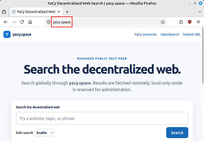

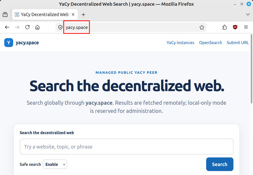

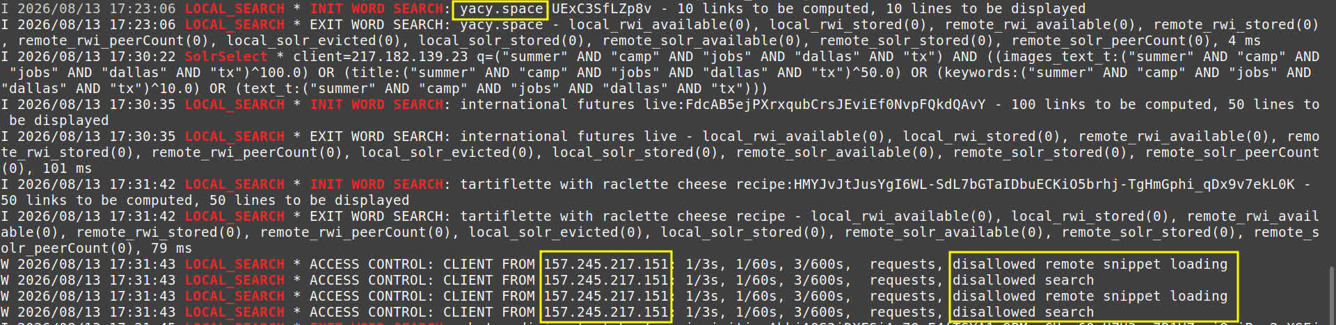

Someone performed quick, local searches on my peer. One of their search queries:
yacy.space

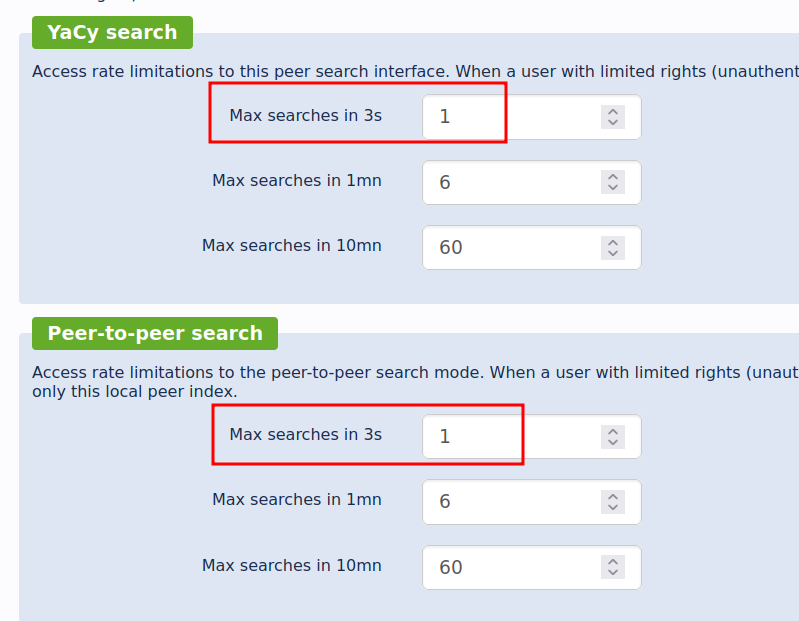

Yacy then complied with admin settings and temporarily blocked an IP address from rapid-fire local searches. The IP address:
http://157.245.217.151
This redirects to yacy.space.
For now, my firewall is blocking that IP address, in an effort to reduce server crashes.
ufw insert 1 deny from 157.245.217.151
