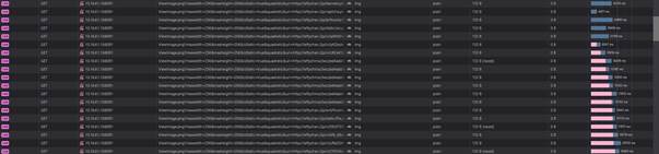

I’ve been using YaCy to crawl I2P, and it works very well overall. However, I’ve run into an issue: the image search doesn’t seem to work at all—no thumbnails are loading.
When I check the browser console, all image URLs return a 500 server error. Strangely, when I visit those URLs directly in the browser, the images load without any problem. For example:
http://leftychan.i2p/music/src/1615683388558.png
This loads fine when accessed directly, but fails through YaCy’s image search.
I should note that, of course, I have significantly increased timeouts due to crawling over I2P, so it’s not a simple timeout issue.
