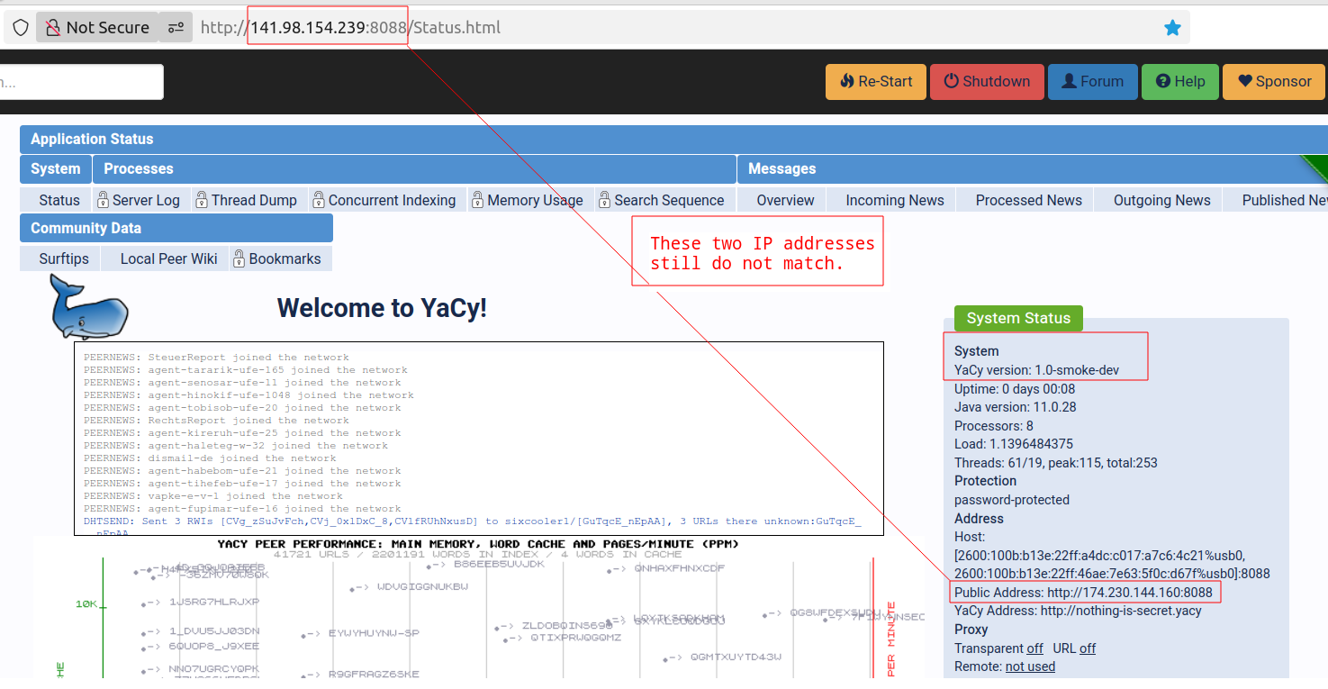

The code compiled successfully. Peer is again Junior and the actual IP address still does not match what Yacy reports in System Status.
But yacy.conf has the correct IP address:
network.external.address=141.98.154.239
So your fork successfully put the working dedicated IP address from my SSH tunnel in the configuration file, but Yacy still does not seem to respect that in the System Status, using instead my cell phone’s public gateway, which cannot receive inbound connections, so it calls my peer Junior.

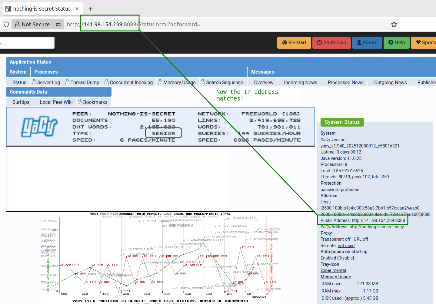

i just use reverse ssh tunnel as described here.
then you just set ip address of your instance to the external ip address in /Settings_p.html?page=ServerAccess (staticIP).
works well for me.
not sure about all these patches. @roamn, do you use AI to generate them?
That worked!
No patches are required. The peer at my house is now Senior, running through a reverse SSH tunnel.
And the IP address was easy to change, if you know the correct settings page.
