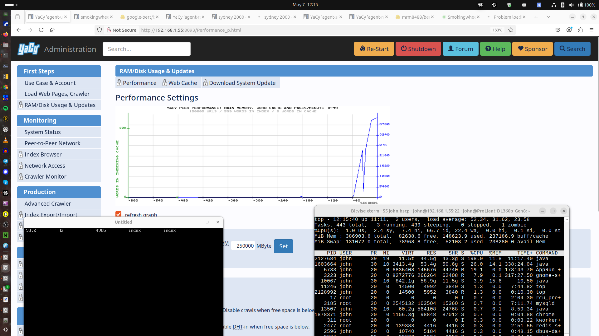

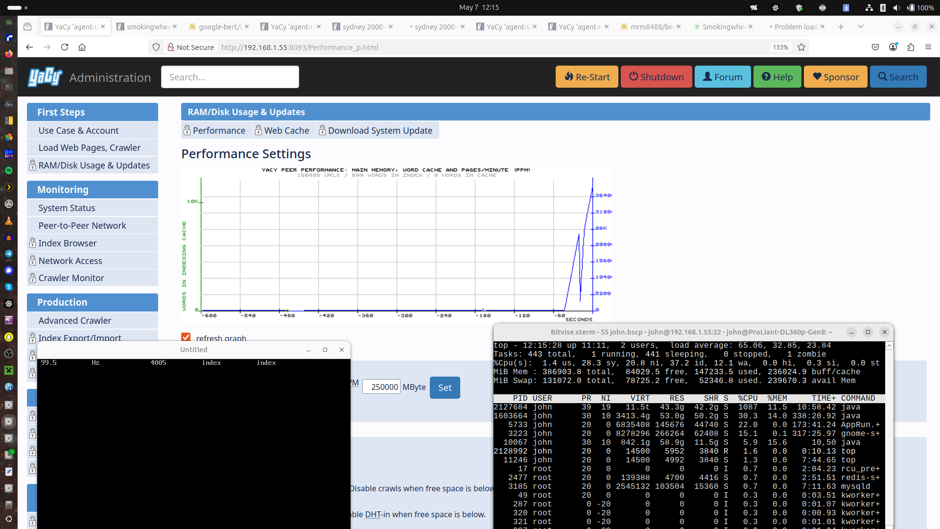

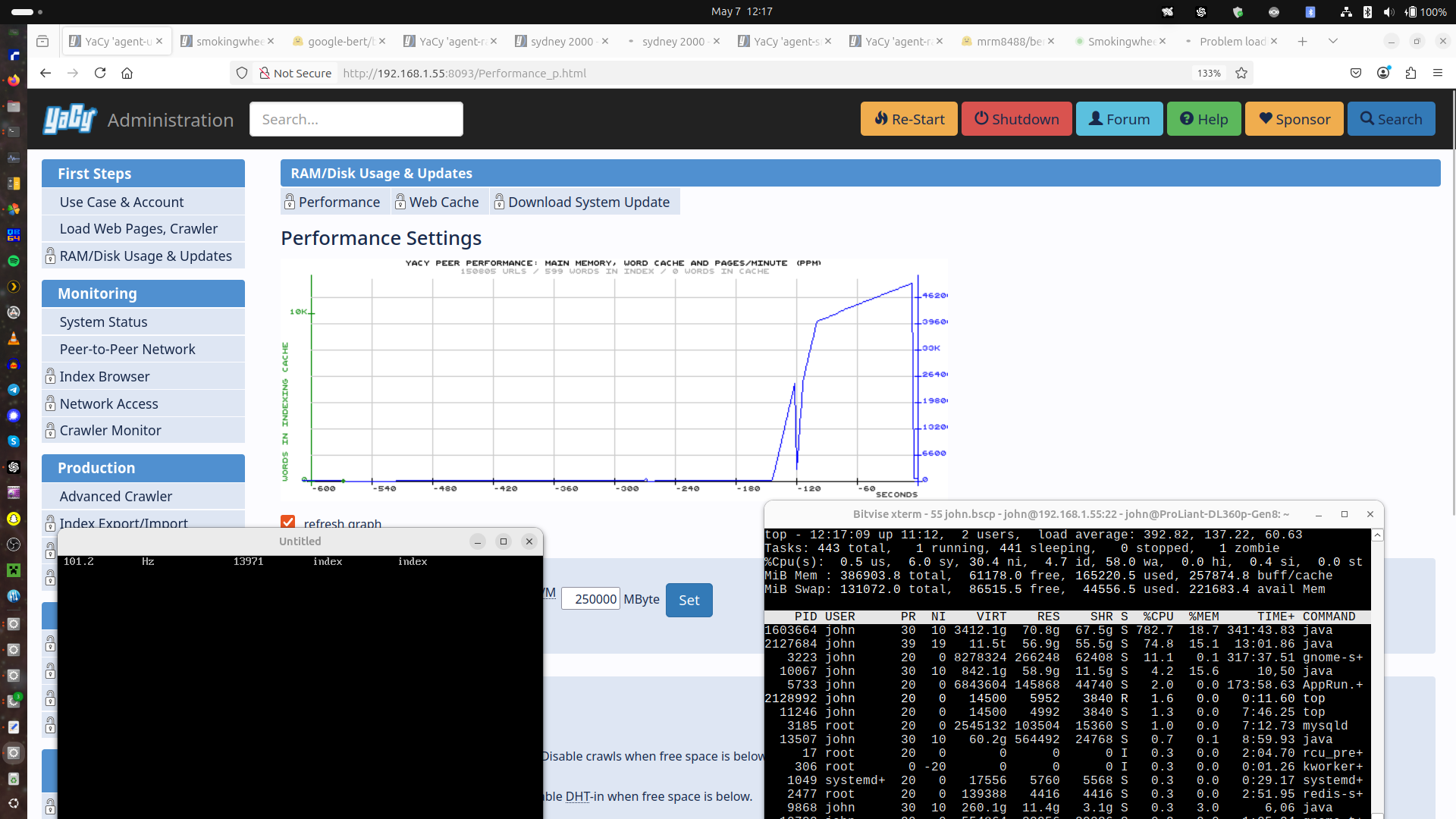

:framed_picture: Visuals:
  • After JVM Update
After starting 4000 queries 100 hz
At 1 min
note cpu avg 392
22 k searches Hz dropped
49 k searches 9 min
My stress tester pc Locked me out and took me to the logon screen. Ubuntu 24.04.
