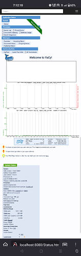

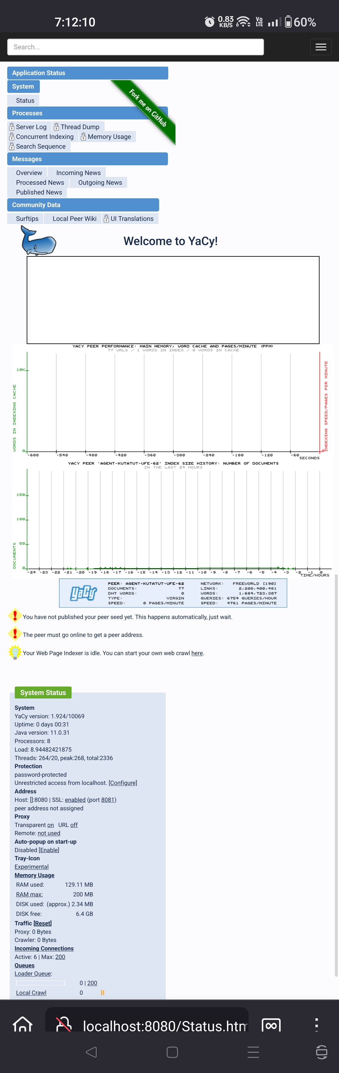

Ok heres my status page sorry its so small but thats the only way I could get it all in. Let me try your suggestion about raising the thing to 20

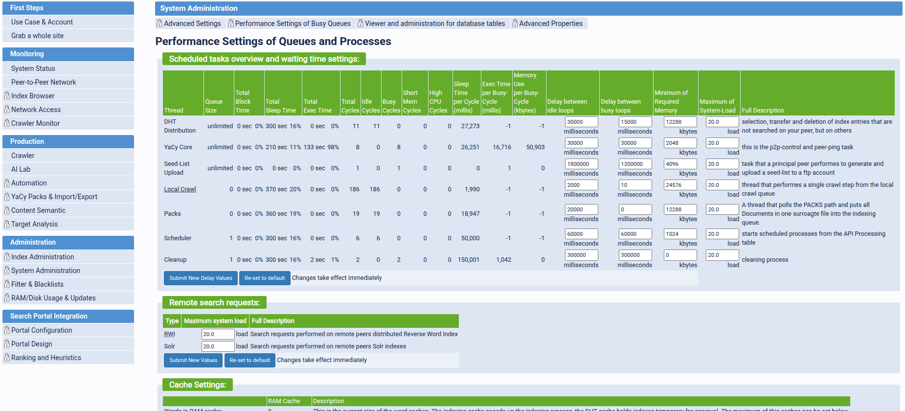

How do I raise the load values? Where do I go in the admin page(s)?
System Administration > Performance Settings and Busy Queues
Thanks a lot Roamn your solution worked. I raised the values from the defaults to 20.0 and bam it hit. So if your on android w Termux/Ubuntu and cant get any search results do this change along with starting your own crawl and you should be good to go
