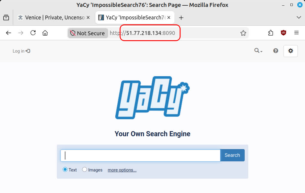

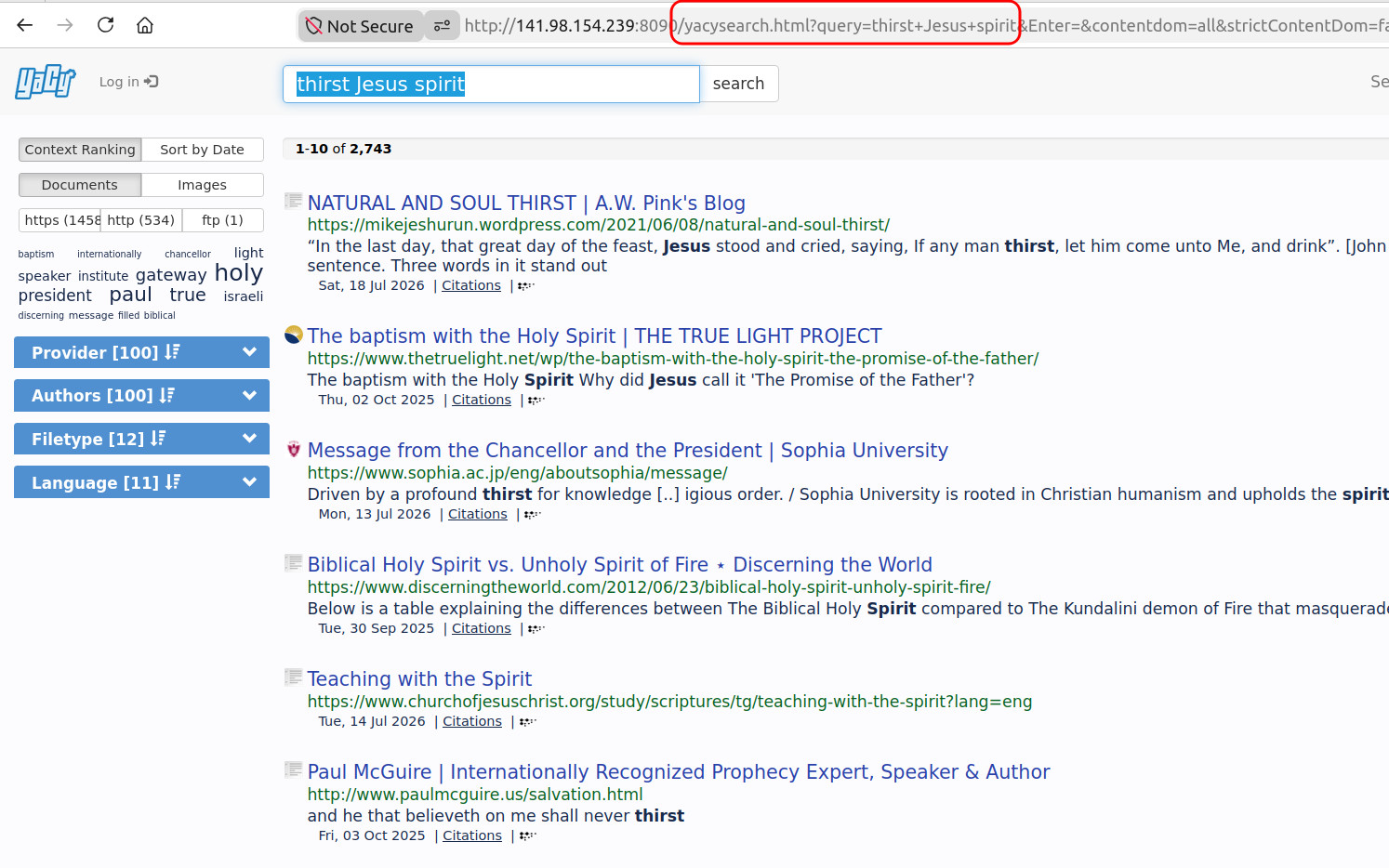

Yes, there are the two search methods: Using the Yacy search interface (like in the web browser) is one.
The other is a solr query, which appears to currently have no admin settings that limit its use.
I prefer the solr query, because it is a more powerful way to search. Ensuring all the keywords desired appear in the results is a huge advantage. So, I would not want to take this feature away, but I would like administration controls to:

I see what you are talking about, you are talking about bypassing the web interface, and I was thinking you were saying bypassing yacy entirely, as if there was a way to query solr remotely without touching the yacy install/interface layer for solr. I’m up to speed now, thanks.
