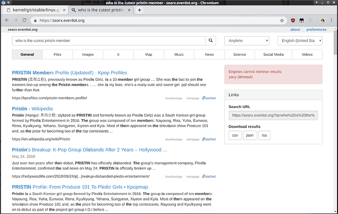

It is possible to configure or alter the code to make YaCy return data or return a blank value within a time-limit? YaCy will typically manage to respond if just one word is given. It will always time-out if a search query has more than 3 words. This is of course a problem in of itself. I use YaCy as a back-end at https://searx.everdot.org/ even though it’s useless crap which provides zero value. That it always time-outs to it’s limit, which I’ve found it’s best to set low. It would be better if a respond-limit would be set in YaCy so it would either respond within a time-limit with what it’s got or return nothing. As of now it can wait minutes before responding if the query is 10 words long.

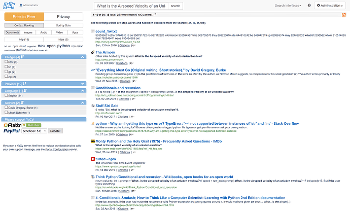

Btw, on my end I don’t have YaCy give up after typing in over 3 words. Your search example just seems to be very very specific in this case. Searching for something like “What Is the Airspeed Velocity of an Unladen Swallow?” which is 9 words long gives me results in a timely fashion:

I can’t replicate your problems on my search engine. I have tried with your keyword who is the cutest pristin member and I’m not getting a timeout.

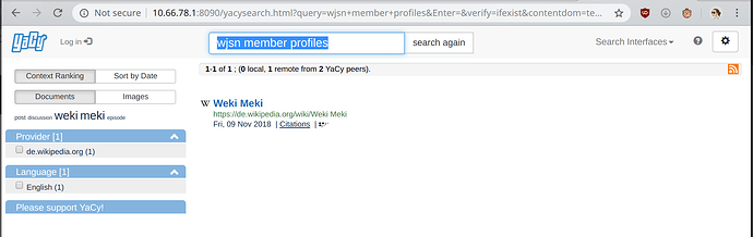

So if you’re having problems finding stuff on YaCy already with the search page failing then there is something with your instance. Seeing the screenshot on the linuxreviews wiki page shows that your instance is never connecting to any other peer. Is it for every search result?
