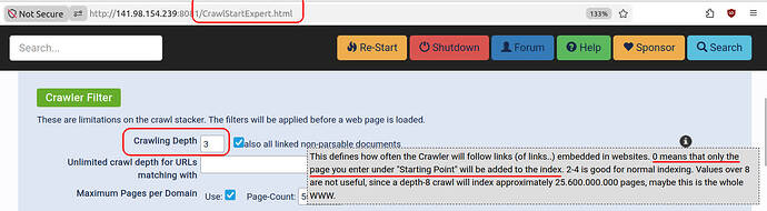

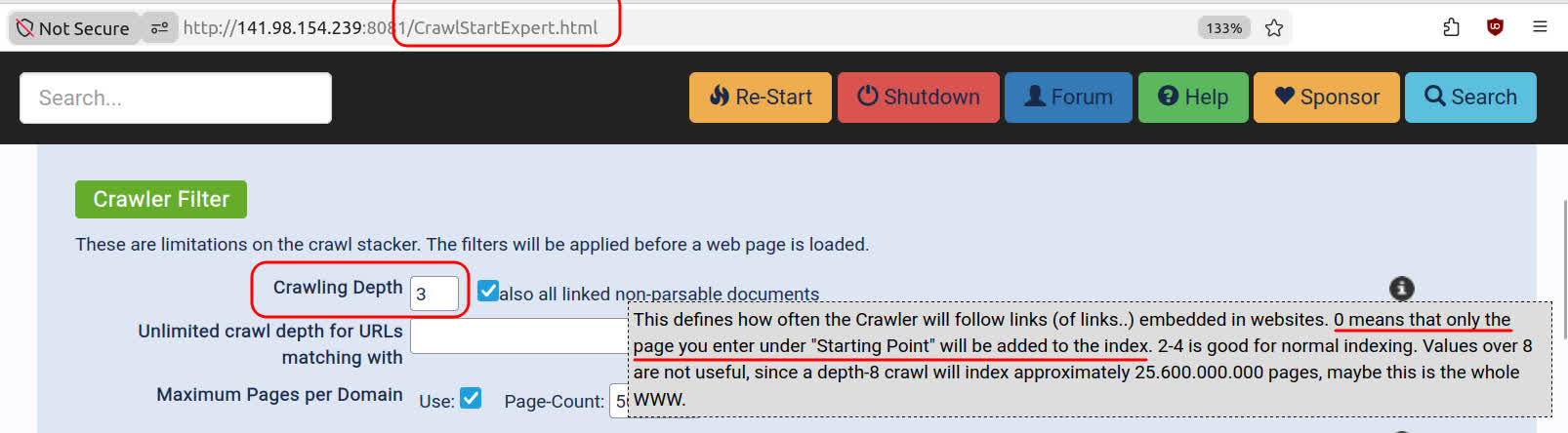

They can, if you specify the crawl depth.
You can see this setting on your page: /CrawlStartExpert.html
